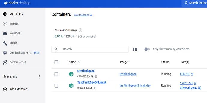

Go into the folder where the Dockerfile is located using the Windows Command Prompt and run the command ‘docker build -t testthinkgeo6 .’ to build the Docker image for deployment. ‘testthinkgeo6’ is the name of the Docker image we are building:
Run the command ‘docker run -d -p 8080:80 --name testthinkgeo6 testthinkgeo6’ to run the Docker container after it has been built successfully,
Now you can see the docker running in the containers list,
and you can access it via a browser
