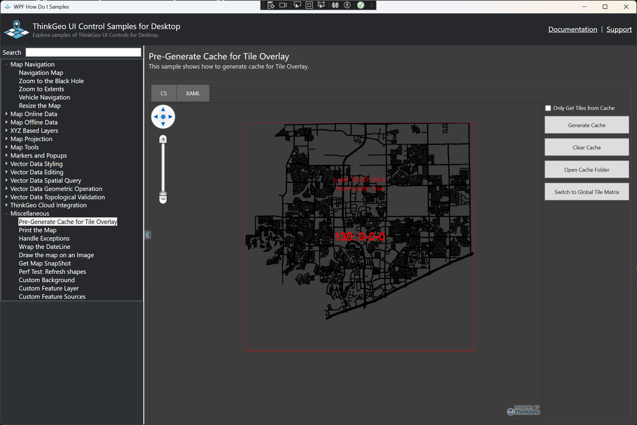

We’ve added a couple of new samples to HowDoI :
The first sample demonstrates how to pre-generate caches for a: TileOverlay :
It shows how to:
  1. Pre-generate cache tiles within a given extent and zoom range using a single line of code.
  2. Apply a different tile matrix set to a TileOverlay and generate the cache based on that matrix.

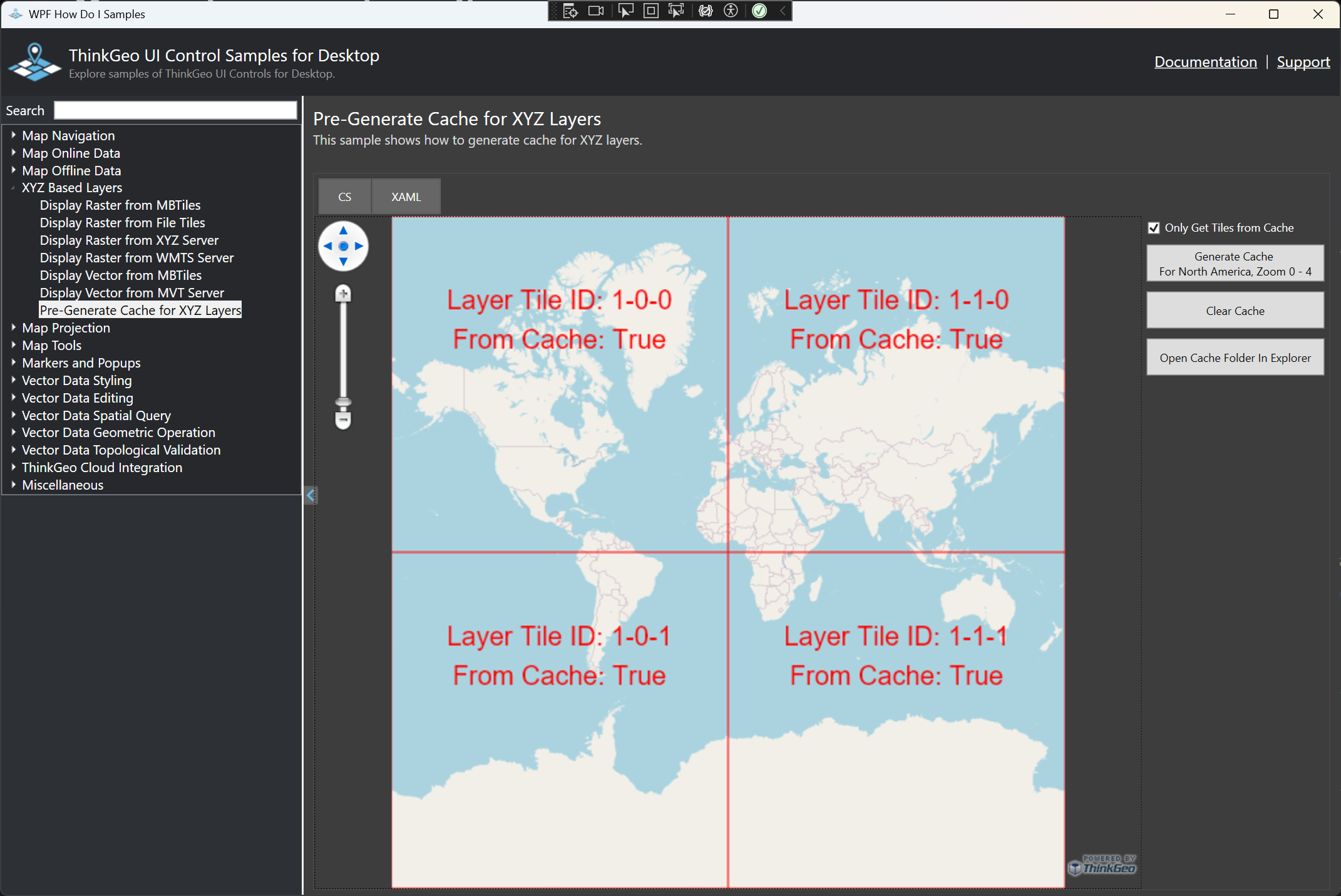

We also added a sample for generating tiles for an XyzLayer . It’s similar to the one above but specifically targets XYZ-based layers:
