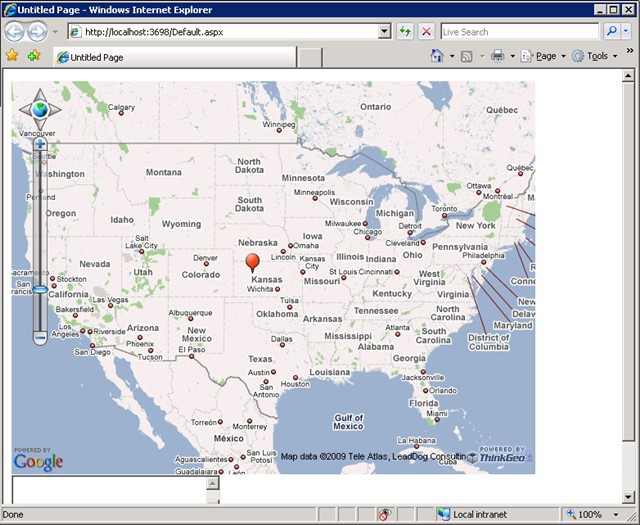

Here is a simple sample how to use it, please let us know if you have any issues.
using System;
using System.Web.UI;
using ThinkGeo.MapSuite.Core;
using ThinkGeo.MapSuite.WebEdition;
namespace WebApplication2
    public partial class _Default : System.Web.UI.Page
        protected void Page_Load(object sender, EventArgs e)
            if (!Page.IsPostBack)
                Map1.CurrentExtent = new RectangleShape(-13939426.6371, 6701997.4056, -7812401.86, 2626987.386962);
                Map1.MapUnit = GeographyUnit.Meter;
                Proj4Projection proj4 = new Proj4Projection();
                proj4.InternalProjectionParametersString = Proj4Projection.GetEpsgParametersString(4326);
                proj4.ExternalProjectionParametersString = Proj4Projection.GetGoogleMapParametersString();
                InMemoryMarkerOverlay inMemoryMarkerOverlay = new InMemoryMarkerOverlay();
                inMemoryMarkerOverlay.ZoomLevelSet.ZoomLevel01.DefaultMarkerStyle.WebImage = new WebImage("../../theme/default/img/marker.gif");
                inMemoryMarkerOverlay.ZoomLevelSet.ZoomLevel01.ApplyUntilZoomLevel = ApplyUntilZoomLevel.Level20;
                // Put the following line of code to a loop to add all the 1000 records
                inMemoryMarkerOverlay.Features.Add("id", new Feature(-100, 40));
                inMemoryMarkerOverlay.FeatureSource.Projection = proj4;
                GoogleOverlay google = new GoogleOverlay("Google Map");
                google.JavaScriptLibraryUri = new Uri(@"maps.google.com/maps?file=api&v=2&key=ABQIAAAAoxK_HcqphMsnUQHEwLwHlRSavkNJi0NVTgm4UDidoiIU5dUJpRQW88FufPCp0aTPraxZgZFAIUHn3Q");
                google.GoogleMapType = GoogleMapType.Normal;
                Map1.CustomOverlays.Add(google);
                Map1.CustomOverlays.Add(inMemoryMarkerOverlay);
