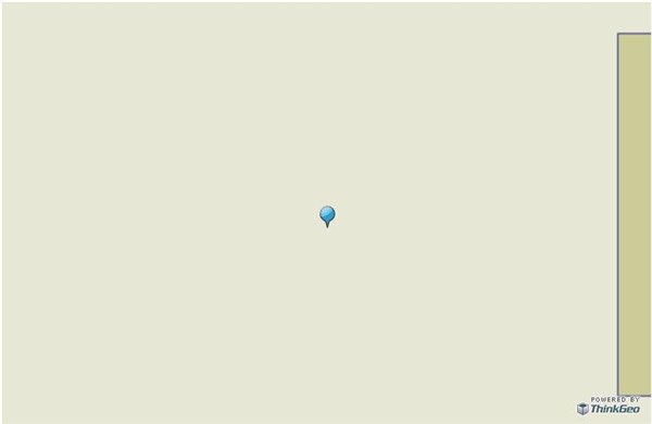

Your c# code works well. The problem might be in the HTML.
If I just drag and drop the map in the page, the result is fine with your code. But if the map is inside a div or a table which is marked “Align=’center’”, I see the problem you described. For example, with the following code in aspx, I recreated your issue. (see Figure 1)
< div align=”center” >
< cc1:Map ID=”Map1” runat=”server” height=”477px” width=”729px” >
< /cc1:Map >
< /div >

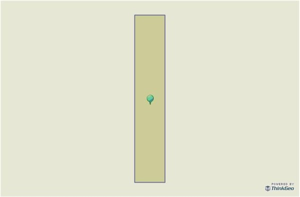

The best way to solve it is adding the “textAlign: Left” style to map control, as following. The result is like Figure 2
 < cc1:Map ID=”Map1” runat=”server” height=”477px” width=”729px” style=”text-align:left” >
Here is my test sample (in VS2008, C#). Have a look at the aspx file to see how to make it work.
In the next beta we will make sure the map control write out the align left style be default.  Thanks for finding and reporting this.
