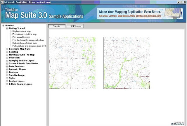

You didn’t send me the World Files so I created them myself. With the world files, your data works fine using the code in your original message. Here is the result and you can see the 2 pics are all added to map. You can change the position/size of the 2 images by modifying the World File. For more info about world file, please see here.
