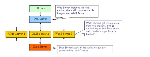

Here is some info about how to add the multi server support and improve the performance. The diagram below shows the structure of the whole system, you can see it could have 4 levels, client browser, web site server, wms server and data server.
Here are some tips for using multi servers,
1, Using Multi-Server in WmsOverlay, tile requests WmsOverlay can be spread out to multi-servers, which reduces the works of each wms server.
The following code specifies how to work with four servers in WmsOverlay.

3, Build up an image server using pre-generated cache files (shows in the first graph). The 2 adjacent images will always come from different WMS server so the servers’ load will be even. It will be great if there has a good Cache Mechanism on Data Server to speed the performance up.
4, The WMS services on different Servers should be all the same.
You can see with WMS Service, it’s easy to distribute it on multi servers and so it has great possibilities to improve the performance, you do not need to manage the session states also. We tested with the multi-WMS Server (with 2 WMS Servers) and it works fine.
