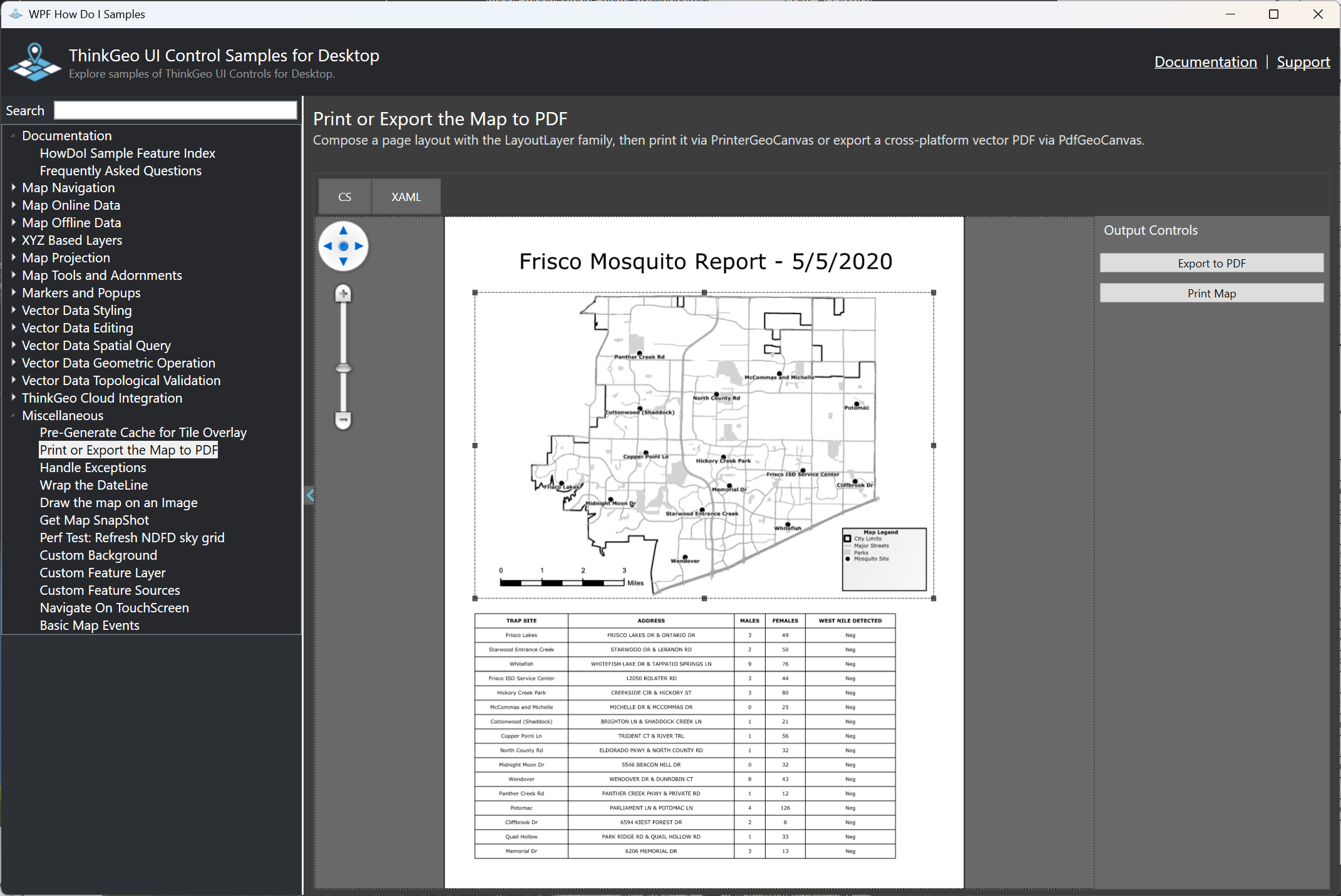

  4. Pull the latest “How Do I” sample and open the “Print or Export the Map to PDF” demo — you’ll see two buttons: “Export to PDF” (new, using PdfGeoCanvas) and “Print Map” (the existing route via the ThinkGeo.Printers extension). Here is the source and below is the screenshot
