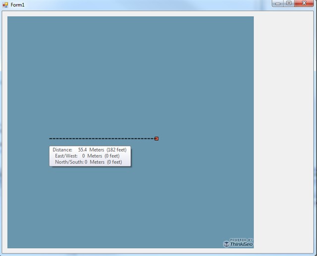

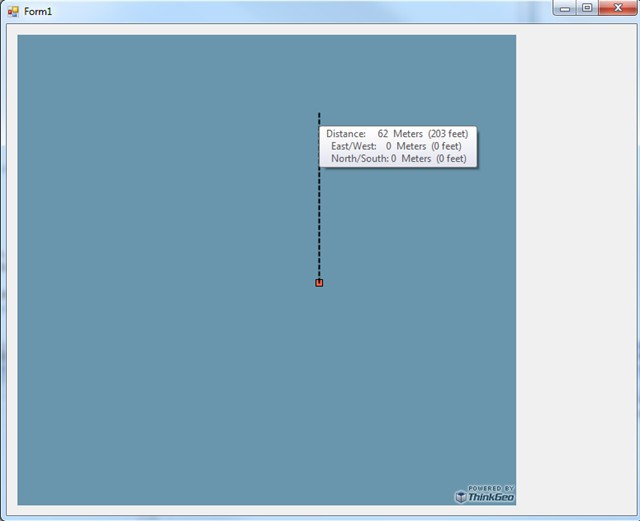

If I am not misunderstood, the exception will happen when your mouse and point in Vertical position or Horizontal position shown below, While it seems strange that this will not happen in my test machine. The attachment is the code (no change from your Form1.cs).
Any more questions please feel free to let me know.
