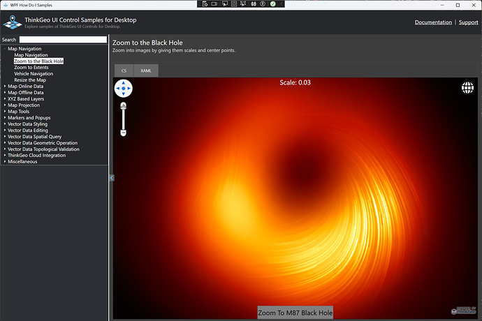

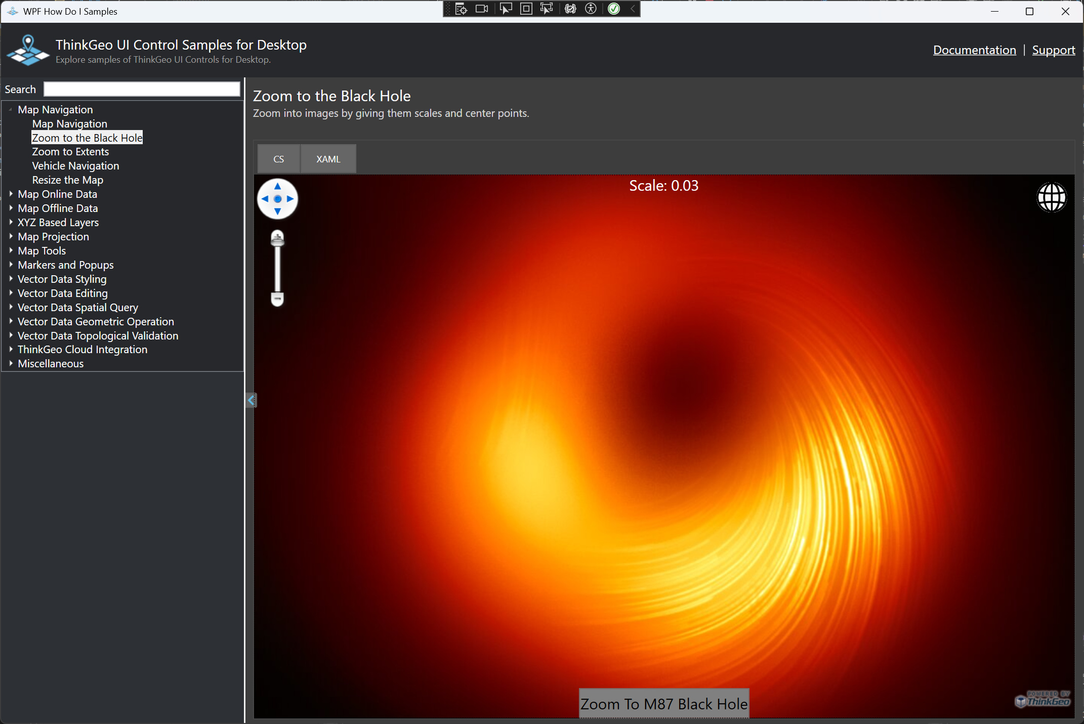

You can even keep using CurrentScaleChanged if changing the visibility of an overlay instead of the layer, which avoids redrawing any layer and is more efficient. In our blackhole sample we do use CurrentScaleChanged to change the opacity of overlays, please check it out if you are interested.
samples/wpf/HowDoISample/Samples/MapNavigation/ZoomToBlackHole.xaml.cs · master · ThinkGeo / Public / Desktop Maps · GitLab
