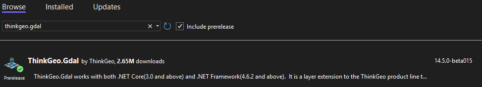

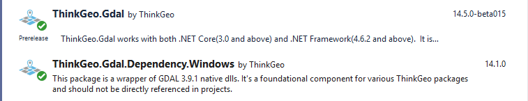

Are you sure? I tried to uninstall just the ThinkGeo.Gdal.Dependency.Windows and got the following error.
Unable to uninstall ‘ThinkGeo.Gdal.Dependency.Windows.14.1.0’ because ‘ThinkGeo.Gdal.14.5.0-beta015’ depends on it.
After uninstalling everything and starting to add back, I see this which clearly says that ThinkGeo.Gdal.Dependency.Windows must be installed…

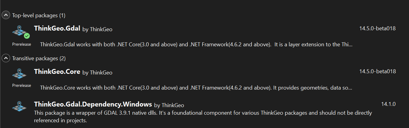

You shouldn’t manually install ThinkGeo.Gdal.Dependency.Windows.
Just install ThinkGeo.Gdal — which will automatically include its dependency ThinkGeo.Gdal.Dependency.Windows .
In the new SDK-style csproj projects, dependent NuGet packages (like ThinkGeo.Gdal.Dependency.Windows) don’t appear at the same level in Visual Studio. That’s why Leo thought you had manually installed it — it showed up as a top-level package in your screenshot. For example here is what it shows up on my end:
There was some issue introduced in beta015 and has been fixed in beta018. I see you have updated to the latest, that’s great. So do you still get “The type initializer for ‘OSGeo.OSR.OsrPINVOKE’ threw an exception.”?
