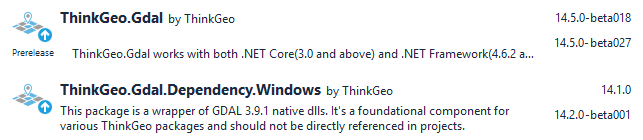

After uninstalling everything and starting to add back, I see this which clearly says that ThinkGeo.Gdal.Dependency.Windows must be installed…
You shouldn’t manually install ThinkGeo.Gdal.Dependency.Windows.
Just install ThinkGeo.Gdal — which will automatically include its dependency ThinkGeo.Gdal.Dependency.Windows .
In the new SDK-style csproj projects, dependent NuGet packages (like ThinkGeo.Gdal.Dependency.Windows) don’t appear at the same level in Visual Studio. That’s why Leo thought you had manually installed it — it showed up as a top-level package in your screenshot. For example here is what it shows up on my end:
