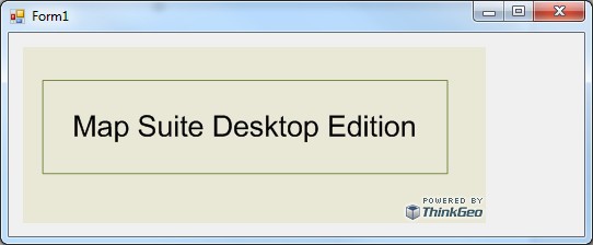

I made a small sample to show the default is center.
Please let me know if you have questions

I have an idea about change the align of label, you know we use center point of polygon as the placement for label, so I just create a point represents center point, and assign text to it, and then I can use point style to easily control the placement of it.
I have updated for my sample, you can look at it.
