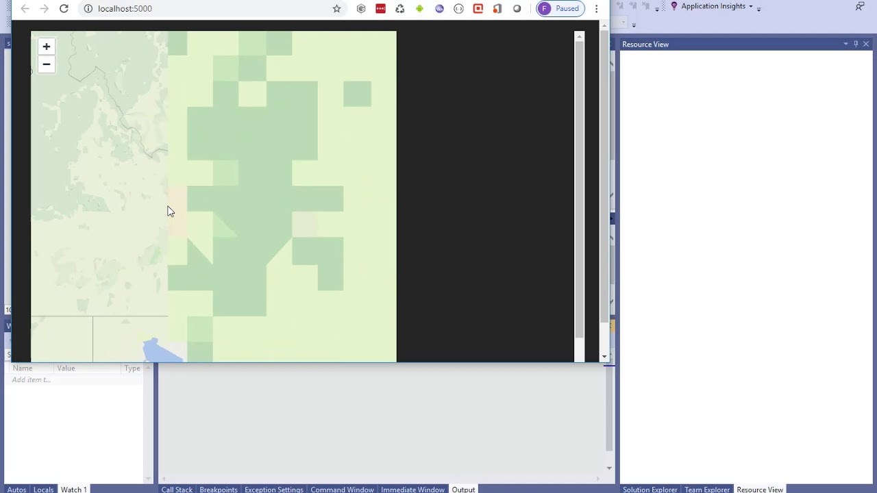

I use two 4k Monitors to develop on. It only happens when the map is full-screen at 4k resolution. If I decrease the resolution to 1080, then it doesn’t seem to happen. Even on a 4k screen, if I don’t have it at full-screen, it works fine.
Check out the video. I have two errors in that video alone; I can reproduce it on command. You’ll also notice that at less than full-screen it does not show the error.

I did more test. It not happen today. It only happen on my machine once or twice last week. Here is the video:
Can you let me know you video card specification. My video card(GTX970M) has 3 gigabytes memory. As talked with my supervisor to support 4k map rendering. We’d better have a powerful video card.
