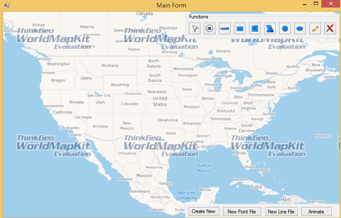

Hi Mengbo,
Please see the sample.  And you can download much more samples from Product Center or wiki.thinkgeo.com/wiki/map_suite_desktop_edition.
Any questions please let me know.
Peter
WinMapSamples.zip (1.02 MB)

Hi Mengbo,
 Very glad to hear that it’s helpful.
 Peter

Hi Scott,
I run the sample I provided before in the thread and it works well on my side, my IDE is Microsoft Visual Studio Community 2015 and the reference version is 9.0.321.0.
From your description I guess the WorldMapKitWmsDestopOverlay doesn’t load successfully. Please try the following steps:
  1. Please make sure the Internet is available.
  2. Please remove the cached tiles, it usually store at “%temp%/MapSuite”
If it’s not the point, could you please provide us more information about your application, such as the concrete reference version?
Hope it’s helpful.
Peter
Peter,
I got it working. I needed to add a reference to DesktopEdition.
When I draw lines on the map like this. Can I output those lines as vertex coordinates in UTM coordinates or Lat/Lon? In a text file?
Scott.
Hi Scott,
Please try the following code to get the vertices for lines.
var lineShapes = winformsMap1.TrackOverlay.TrackShapeLayer.InternalFeatures.Where(f => f.GetShape() is LineShape).Select(p => p.GetShape()).Cast<LineShape>();
foreach(var shape in lineShapes)
    var vertices = shape.Vertices;
NOTE:
If the mapUnit is DecimalDegree the vertices are in the Lon/Lat format.
Peter
