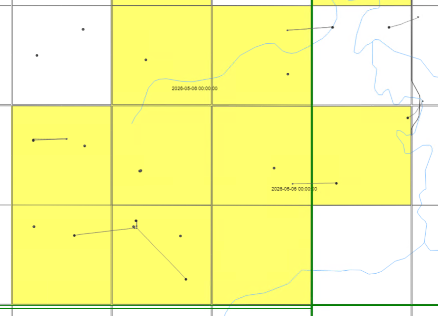

Hey, I am now running 14.5.1, and I am once again seeing problems with the date formatting.
I set a text style like this and check it with the formatted event.
if (columnType == ColumnType.DateTime)
textStyle.DateFormat = “{0:d}”;
textStyle.Formatted += FormattedHandler;
In the formatted event, I see that it has correctly formatted the date to the short date.
“2026-05-06”
But when it is finally rendered on the screen, I see
Notice the time is still appended to the date. What am I missing now?
I swear that this working a while ago.
Hi Chris,
You’re right, this was a regression on the polygon label path. It’s been fixed in 15.0.0-beta037. Same fix also addresses a sibling issue where multi-line polygon labels (AllowLineCarriage / ForceLineCarriage) stacked all lines at the same Y. Pull the new beta and textStyle.DateFormat = “{0:d}” will render as 5/7/2026.
