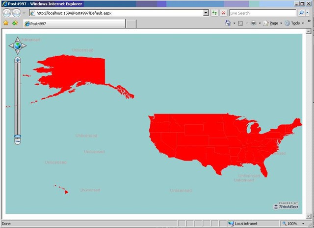

Here is a new sample where we change the viewing ZoomLevel01 to the layer’s full extent. Sure you can set it to any RectangleShape if you want.
I didn’t change the drawing ZoomLevel in this sample, please reference the first sample if you want to implement that. I think now you can zoom in much more on your cities layer. Any queries please let us know.

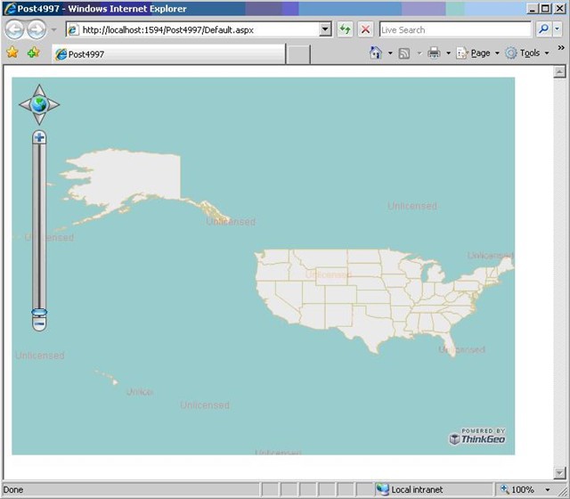

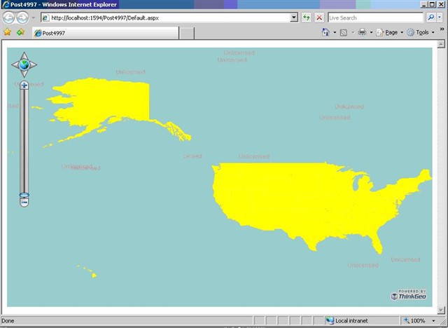

You mentioned changing the ZoomLevel scales didn’t seems to affect the ZoomLevels.  Here is a sample where you can find if you comment the code of Changing the ZoomLevelSet, result will be different. Just wonder if I misunderstand something about the “affect” you means, maybe you didn’t mean the appearance but something else?
Use the Default ZoomLevel
Change the Default ZoomLevel
239-Post4997_3.zip (93.9 KB)
