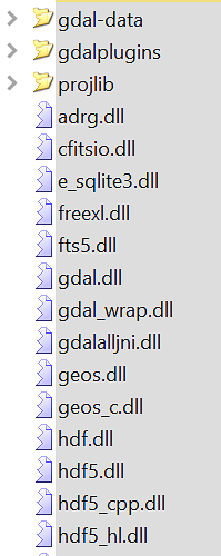

I see the issue. For some reason the gdal dlls/files are not copied to the right spot when building in dotnet framework.
We will start to work on it. Before the fix is ready, you can work it around by coping the missing dlls/files to runtimes\win-x64\native, the missing files look like following, I’d suggest you build the project in net80, and then copy the corresponding files form net8.0-windows\runtimes\win-x64\native to net48\runtimes\win-x64\native

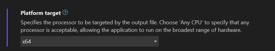

Can you right click your project and change Platform target to x64, as following:
Rebuild and the gdal files will then copy to runtimes\win-x64\native. By default in dotnet framework, they are only copied to runtimes\win-x86\native
