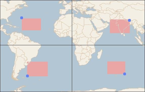

The map is simply divided into 4 pieces (2*2) and the popup's direction is according to which phase the marker is within. For example if the marker is within the upper left one, the popup will always on the lower right side of the marker, like what shows on the following graph in which blue point represents a marker and the pink rectangle represents the popup.

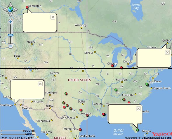

Has there been any update on this?  I would really like to customize our VauleItemStyle-based popups using custom html, but I cannot create one similar to the CloudPop without being able to know which "phase" of the viewport I'm in.

I want to be able to accomplish the following when hovering over markers using CustomPopups based on our own custom HTML and styles/images similar to the ThinkGeo CloudPop.  The main thing I need is the "Phase" number of the viewport when hovering over markers on the map.  Knowing this I could apply the appropriate style and get the marker's popup to show up in the right direction.  Any help would be appreciated.
