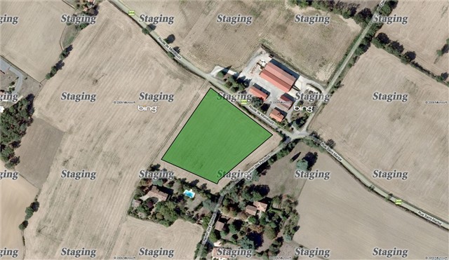

I draw this feature :

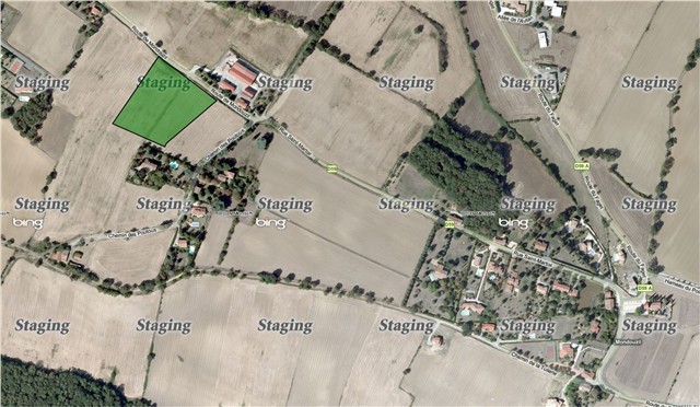

When I zoom on it :
I have to zoom once again to have the good match.
When I pan the map :

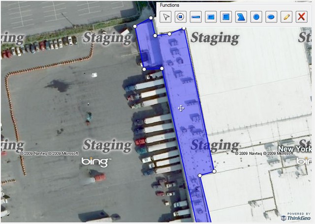

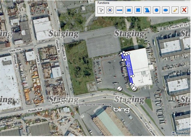

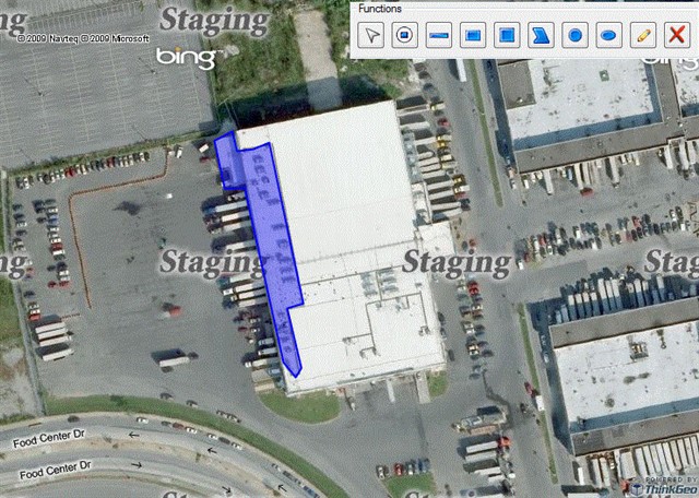

Following is three screenshot with zoomin and zoomout.
