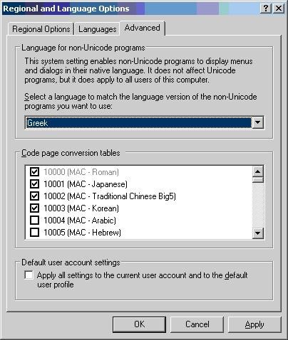

By default, Map Control will show labels based on system’s current encoding. So if your System is already under Greek, it should display the Greek labels properly.
Here is how to set your system’s encoding. (Need restart after change)
Start->Control Panel ->Regional and Language Options->Advanced Tab
