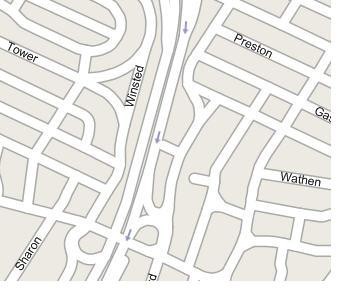

I have an shp file containing a column name called ONE_WAY_ , it has diferents values for one-way and two-way roads based on the order of the start and end nodes,  the order is determined by the way the shapefile is digitized, value=0 for both direction or two-way roads, value = 1 for one-way roads direction going from first node to last one and value = 2  for one-way roads direction going from last node to first one.
Is it posible to draw an arrow in the streets like googlemaps do?

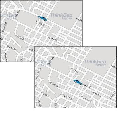

We have a sample which shows side view icon in code community, you just need change the car icon to your arrow icon.
code.thinkgeo.com/projects/show/sideviewicon
Please let me know if you have more questions
James
Leandro,
 Actually, the project referenced in the Code Community shows a slightly different issue. It shows how to rotate icons based on the direction of the vehicle. Although the basic math is the same, it needs to be used differently. I am currently working on the exact solution for your case. Thank you.
