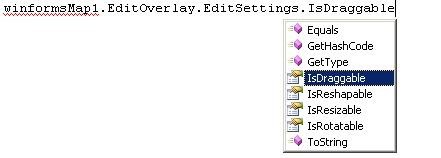

 3.  When in editing mode, all of the vertices of the feature are highlighted.  I notice there are a few extra markers.  One appears to enlarge the feature as if it is a bounding box.  Another rotates the feature.  Can these be toggled on and off depending on the type of edit I want to do?

3, There are a couple of switches like IsResizable, IsRotatable. Please see the snap short below.
