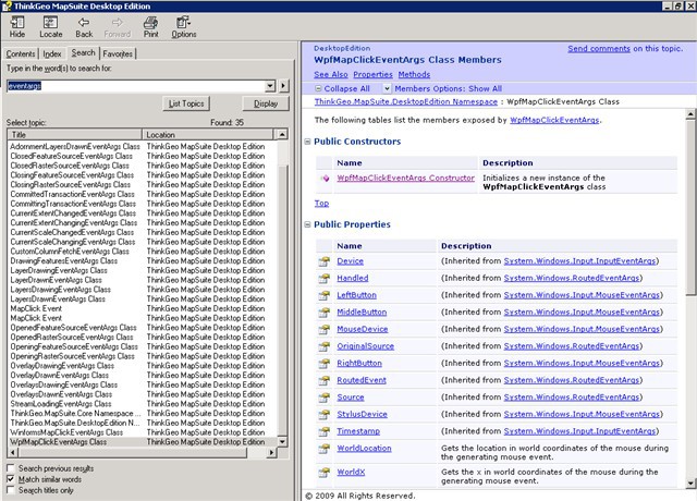

Yes Ben, but how can we know what types of event data generated byt the event are available for WPF? is there any list, or we just look at Intellisense like when we type "wpfMap1.MapClick+=" then press TAB key, to see the "WpfMapClickEventArgs<wpfmapclickeventargs></wpfmapclickeventargs>"?
Ric,
Open the API Documentation and search “eventargs”, you will see all the event args within our system. The one starts with “Wpf” is available specific for wpf component. For now, you can see there is only one “WpfMapClickEventArgs”. For its own events of a wpf component, we need to check msdn to find what's their event args. For example, wpfMap1.MouseDown event uses the “MouseButtonEventArgs”, we need to check it ourselves how to use it.
