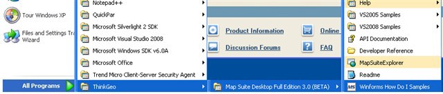

Can you try to run the HowDoI sample exe shown as following screen shot to see whether it is running well?
Hello Yale,
 YES! I have change my PC and the name of it. Must I change the name with the old one and reinstall mapsuite or what must I do ?
 Winforms How Do I samples runs well.
