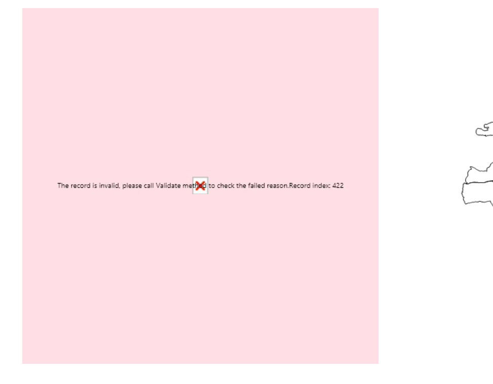

When loading in any Shapefile into an empty Overlay, I get following exception:
internal static void FileNotOpen()
throw new ObjectDisposedException(null, Environment.GetResourceString(“ObjectDisposed_FileClosed”)); <–
“The record is invalid, please call Validate to check the failed reason. Record index: 823” (index changes)
ThinkGeo.UI.Wpf.TileOverlay.d__97.MoveNext()
Also see below. The points still load in all the same from what ive seen.

The error seems to be thrown here:
    public RectangleShape GetExtent(IViewerLayer layer)
        RectangleShape ret = null;
        try
            if (layer.MapLayer != null)
                if (layer.MapLayer.HasBoundingBox)
                    layer.MapLayer.Open();
                    ret = layer.MapLayer.GetBoundingBox();
                    layer.MapLayer.Close(); <--
        catch (Exception)
        return ret;
ThinkGeo.Core.dll!ThinkGeo.Core.ShapeFile.zSM=(int recordIndex)	Unknown
ThinkGeo.Core.dll!ThinkGeo.Core.ShapeFileFeatureSource.GetAllFeaturesCore(System.Collections.Generic.IEnumerable<string> returningColumnNames)	Unknown
ThinkGeo.Core.dll!ThinkGeo.Core.FeatureSource.GetFeaturesInsideBoundingBoxCore(ThinkGeo.Core.RectangleShape boundingBox, System.Collections.Generic.IEnumerable<string> returningColumnNames)	Unknown
ThinkGeo.Core.dll!ThinkGeo.Core.ShapeFileFeatureSource.GetFeaturesInsideBoundingBoxCore(ThinkGeo.Core.RectangleShape boundingBox, System.Collections.Generic.IEnumerable<string> returningColumnNames)	Unknown
ThinkGeo.Core.dll!ThinkGeo.Core.FeatureSource.GetFeaturesInsideBoundingBox(ThinkGeo.Core.RectangleShape boundingBox, System.Collections.Generic.IEnumerable<string> returningColumnNames)	Unknown
ThinkGeo.Core.dll!ThinkGeo.Core.FeatureLayer.DrawCore(ThinkGeo.Core.GeoCanvas canvas, System.Collections.ObjectModel.Collection<ThinkGeo.Core.SimpleCandidate> labelsInAllLayers)	Unknown
ThinkGeo.Core.dll!ThinkGeo.Core.ShapeFileFeatureLayer.DrawCore(ThinkGeo.Core.GeoCanvas canvas, System.Collections.ObjectModel.Collection<ThinkGeo.Core.SimpleCandidate> labelsInAllLayers)	Unknown
ThinkGeo.Core.dll!ThinkGeo.Core.Layer.FCA=(ThinkGeo.Core.GeoCanvas canvas, System.Collections.ObjectModel.Collection<ThinkGeo.Core.SimpleCandidate> labelsInAllLayers)	Unknown
ThinkGeo.Core.dll!ThinkGeo.Core.Layer.Draw(ThinkGeo.Core.GeoCanvas canvas, System.Collections.ObjectModel.Collection<ThinkGeo.Core.SimpleCandidate> labelsInAllLayers)	Unknown
ThinkGeo.UI.Wpf.dll!ThinkGeo.UI.Wpf.LayerTileView.DrawLayerAsync.AnonymousMethod__1()	Unknown
mscorlib.dll!System.Threading.Tasks.Task.InnerInvoke() Line 2724 C#
It looks like record 422 is invalid. You can either:
  1. Send us the shapefile so we can take a closer look, or
  2. Pull the latest beta (Beta023) and try again — this version doesn’t fix the issue yet, but it logs more detailed exception information.
