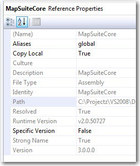

Also noticed that Visual Studio properties of MapSuiteCore differ from the File properties of said same DLL.
