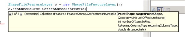

Here is the sample code how to add it. (.Net 3.5 required)\
 public static class GetFeaturesExtender
        public static Collection<Feature> GetFeaturesNearestTo(this FeatureSource featureSource,
            PointShape targetPointShape,
            GeographyUnit unitOfFeatureSource,
            int numberOfItemsToFind,
            ReturningColumnsType returningColumnsType,
            double distanceLimits)
            RectangleShape rectangleShape = GetBoundingBox(targetPointShape, distanceLimits);
            Collection<Feature> filterFeatures = featureSource.GetFeaturesInsideBoundingBox(rectangleShape, ReturningColumnsType.NoColumns);
            if (filterFeatures.Count == 0)
                return new Collection<Feature>();
            else if (filterFeatures.Count < numberOfItemsToFind)
                numberOfItemsToFind = filterFeatures.Count;
            return featureSource.GetFeaturesNearestTo(targetPointShape, unitOfFeatureSource, numberOfItemsToFind, returningColumnsType);
        private static RectangleShape GetBoundingBox(PointShape centerPoint, double radius)
            return new RectangleShape(centerPoint.X - radius,
                centerPoint.Y + radius,
                centerPoint.X + radius,
                centerPoint.Y - radius);
Then you can use this API directly in a FeatureSource.
