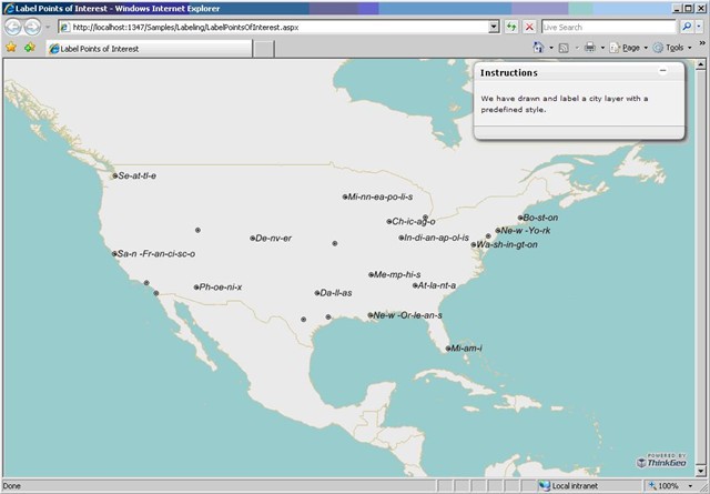

Here also attached the code specific for your case, as well as the result as following. For any issues please let us know.
