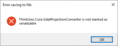

I have a layer that has been assigned a GdalProjectionConverter. When trying to serialize the layer to file, I get a serialization error. How should this be treated?

GdalProjectionConverter is not marked as Serializable because some of its internal fields are not serializable. What serialization methods are you using? We’ll see if there’s some way we can work it around?
Using normal GeoSerializer.
Damian
Just fixed it and created a new version for you, pull the latest (ThinkGeo.Gdal 14.4.0-beta087 ) and have another try.
