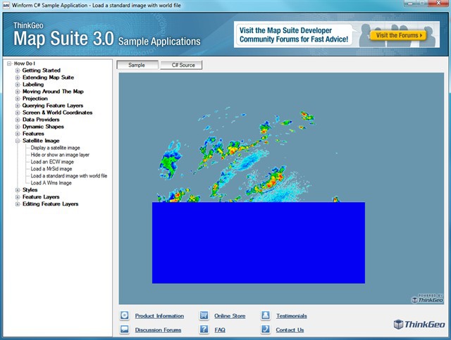

I tried the data your provided and it works fine. Following is the code for it and its screenshots.
    winformsMap1.MapUnit = GeographyUnit.DecimalDegree;
            winformsMap1.BackgroundOverlay.BackgroundBrush = new GeoSolidBrush(GeoColor.GeographicColors.ShallowOcean);
            GdiPlusRasterLayer worldImageLayer = new GdiPlusRasterLayer(@"C:\Post6073\sample\sample.gif");
            worldImageLayer.UpperThreshold = double.MaxValue;
            worldImageLayer.LowerThreshold = 0;
            LayerOverlay ImageOverlay = new LayerOverlay();
            ImageOverlay.Layers.Add("WorldImageLayer", worldImageLayer);
            winformsMap1.Overlays.Add(ImageOverlay);
           // winformsMap1.CurrentExtent = new RectangleShape(-118.098, 84.3, 118.098, -84.3);
            worldImageLayer.Open();
            winformsMap1.CurrentExtent = worldImageLayer.GetBoundingBox();
            worldImageLayer.Close();
            winformsMap1.Refresh();
ScreenShot:
Let me know if any more questions.

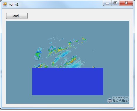

Ryan,
I am sorry to say that the samples from our support still can work correctly. Following is the screenshot:
I found the current extent is not set correctly before you refresh. Please try the following code in the button click event:
