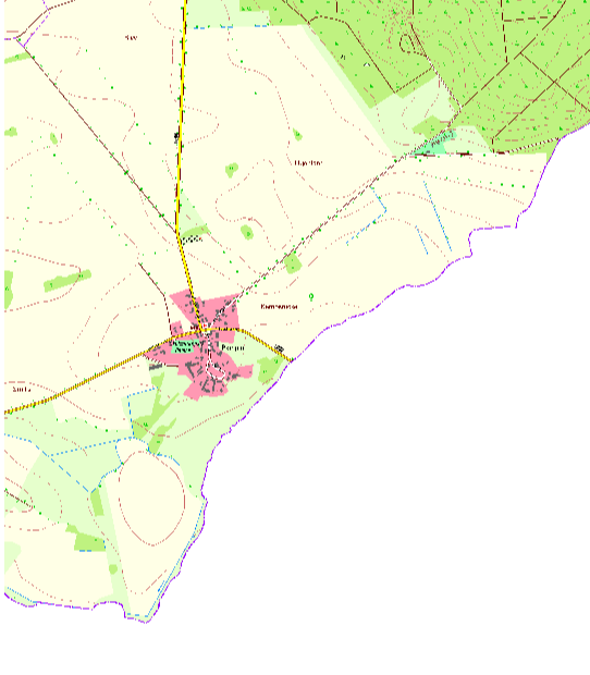

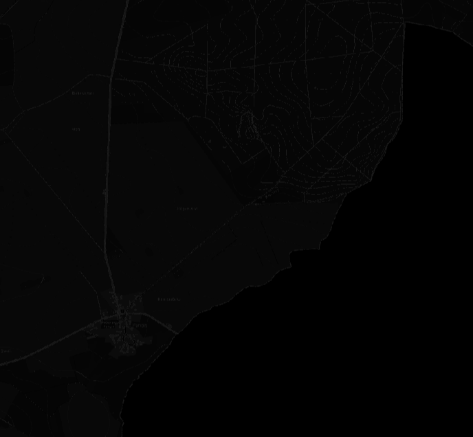

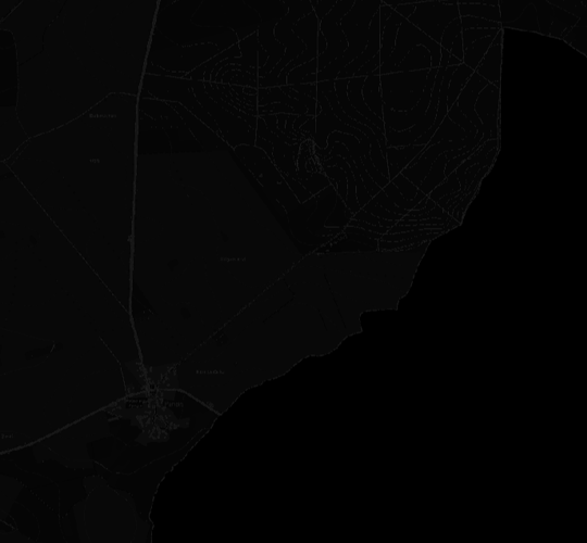

Hallo,
some of our customers use tif-files as background layer. If we use GeoTiffRasterLayer for the images, the map will be rendered correctly. But if we use GeoTiffGdalRasterLayer the map is black.
Unfortunately the GeoTiffGdalRasterLayer is much faster then GeoTiffRasterLayer.
Are there any suggestions to use GeoTiffGdalRasterLayer?
If it is helpful, i can upload a tif-file.
Regards
Torsten
Hi Torsten,
Can you upgrade to v14, which uses GDAL 3.9.1, if you haven’t done so? Also please send over the tif file. You can send it to support@thinkgeo.com if it’s too large uploading here.
Hi Torsten,
We got the test file you sent over, recreated the issue, and fixed it in the latest beta ThinkGeo.Core 14.3.0-beta137. Please have a try. This fix will be included in the upcoming release v14.3 which we are aiming to release next week.
