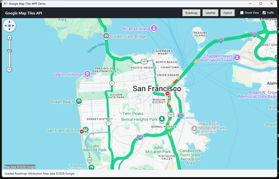

The screenshot below shows the new GoogleMapTilesOverlay running in a WPF sample with the traffic layer enabled.

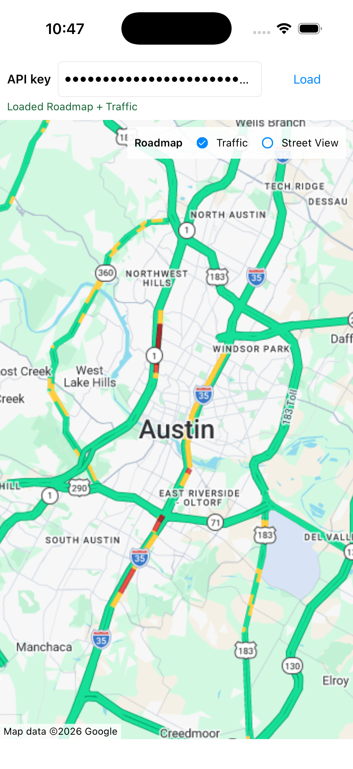

Enter your Google Maps Platform API key and click Load. The Google map tiles should load as shown below on an iOS emulator.
The sample targets Android, iOS, and Windows.
