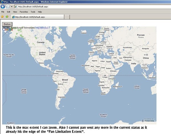

1, I think you have guessed right that the exception is because of an out of range extent. As you wondered, we have an API “Map.RestrictedExtent” to limit the “pan”. We are now trying to make it limit the “zoom out” for GoogleMap also; maybe you can see it in the next beta release.
2, For now, you can set the RestrictedExtent to limit the “pan” and set a “max Zoom” to limit the “zoom out” by comparing the current extent with the MaxExtent in every ZoomEnd event. Please see the codes attached. It works in my machine with the latest public release (WebEdition 3.0.2, NetTopologySuite.dll 1.7.1.27881).

Thanks very much.  I have implemented the RestrictedExtent property and the JavaScript code you attached.  It works great and is exactly what I needed to limit the Zoom (and Pan which I hadn't even thought of before).  Thanks again!
