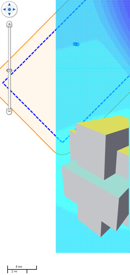

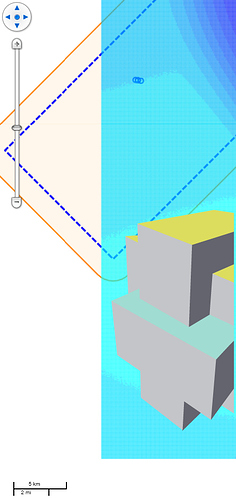

So is GraphicAdornmentOverlay used for anything now? Why should I be able to set it up if it doesn’t do anything??? It doesn’t say anything about being deprecated.
This code gives me an error because I am not using a URI, but rather an image loaded as a resource. Barring that though, this code gets me this image… which does not even anchor the image to the bottom right (see image 2 where logo is clipped) and clearly does not honor the rendered size of 80x80 pixels.

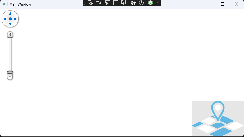

Hi @Damian_Hite,
To get your code working, the following changes are required:
  1. save with the correct ImageFormat, if your logo image is png, just save it with ImageFormat.PNG
  2. reset the position of the stream before passing it to GeoImage
I uploaded a sample with comments, feel free to have a look.
GraticuleAdornmentSample.zip (18.4 KB)
Leo
Thanks Leo. That worked, but I had to set the MapTools.Logo to a blank BitmapImage; otherwise, both were displayed at the same time.
Damian
Hi @Damian_Hite,
You could hide the Logo using the following code.
        MapView.MapTools.Logo.Visibility = Visibility.Collapsed;
