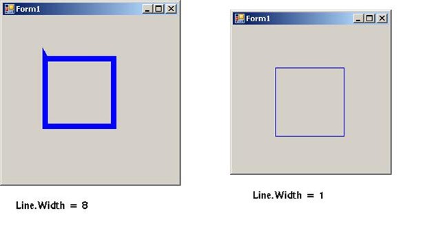

We have 2 properties for that. One is Map.SmoothingMode and the other is Map.CompositingQuality. They are all GDI+ properties and you can set both of them to “HighQuality”.
However, it might not remove all your spikes even you set that. It’s a GDI+ issue that in one line, if 2 adjacent points are very close and the width of the line is not thin, it will have spikes. You can see the attached GDI+ demo that even with the ComposingQualith and SmoothingMode both set to HighQuality, there are still spikes.
Reset the styles can solve that issue. For example, originally you set the width of the US outline to 3 from ZoomLevel10 to ZoomLevel20, you can change the within to 2 for ZoomLevel10 and apply the width of 3 only from ZoomLevel11 to ZoomLevel20.  As the width gets fewer, you have less possibility to see spikes within ZoomLevel10; also when zoom in to ZoomLevel11, the distance between 2 adjacent points gets larger so it also has little possibility to have spikes there. Have a couple of try on that and I think it’s no doubt to remove all the spikes.

191-SpikeSample.zip (9.49 KB)
