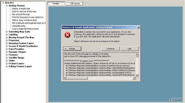

When I run the "How Do I Samples" I get this erro message as in the attached image , Why?

BANDAR,
I think the reason is that your sample is running at offline environment or your Internet is not stable that can not connect our remote server.
You can set the property DrawingExceptionMode of WorldMapKitWmsDesktopOverlay to DrawException instead of ThrowException which is default;
WorldMapKitWmsDesktopOverlay worldMapKitDesktopOverlay = new WorldMapKitWmsDesktopOverlay();
worldMapKitDesktopOverlay.DrawingExceptionMode = DrawingExceptionMode.DrawException;
winformsMap1.Overlays.Add(worldMapKitDesktopOverlay);
