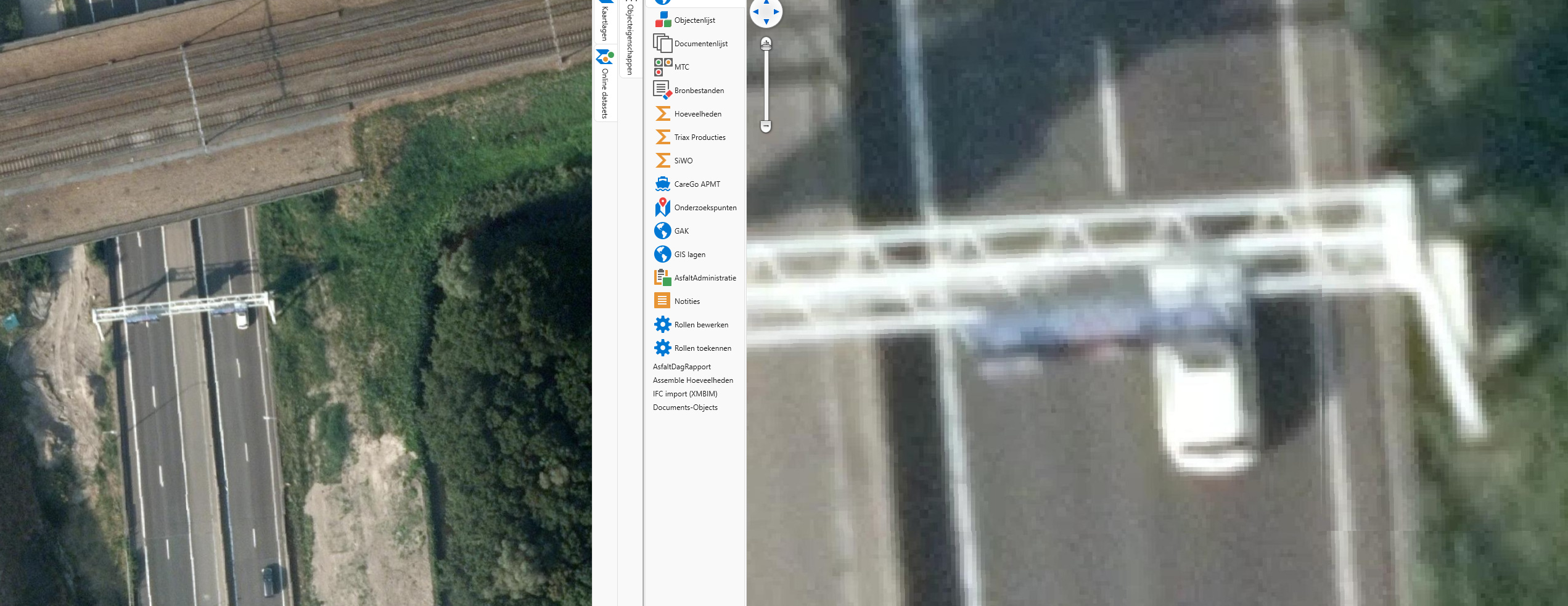

Max zoomlevels in latest version (left) and current version (right).

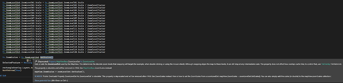

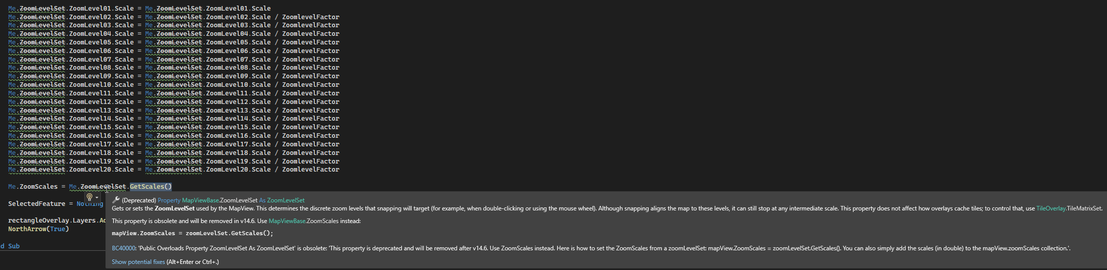

Hi Ben,
This picture is what I was refering too.
‘Public Overloads Property Zoomlevelset as Zoomlevelset’ is obsolete and will be remove after v14.6.
As English is not my native language, I have no idea what this means.
To me it seems that this code for changing the default zoom scales will not work after v14.6.
Guido van den Boom
Hi Guido,
I see. It means MapView.ZoomLevelSet is obsoleted, but you can use MapView.ZoomScales to set up the custom zooms. Here is some quick demo code:
