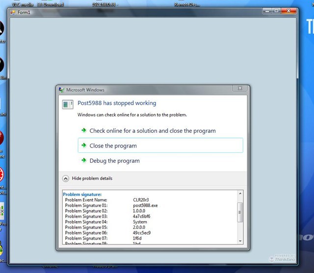

Yale,
when running the exe directly, nothing is displayed.
When i try to pan the map are i get an error as displayed in the attached file.
the content of the problem details is as follows:
Description:
Stopped working
Problem signature:
Problem Event Name: CLR20r3
Problem Signature 01: post5988.exe
Problem Signature 02: 1.0.0.0
Problem Signature 03: 4a7c6bf6
Problem Signature 04: System
Problem Signature 05: 2.0.0.0
Problem Signature 06: 49cc5ec9
Problem Signature 07: 1f6d
Problem Signature 08: 1bd
Problem Signature 09: System.Net.WebException
OS Version: 6.0.6002.2.2.0.256.6
Locale ID: 1033
I cannot see my attached file so here is another try
