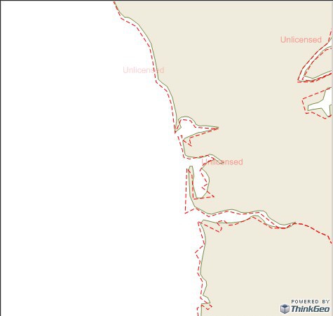

Here is a simple sample with it's result.
GeoPen dashPen = new GeoPen(GeoColor.StandardColors.Red, 1);
dashPen.DashPattern.Add(6);
dashPen.DashPattern.Add(3);
USLayer.ZoomLevelSet.ZoomLevel01.DefaultAreaStyle = new AreaStyle(dashPen);
USLayer.ZoomLevelSet.ZoomLevel01.ApplyUntilZoomLevel = ApplyUntilZoomLevel.Level20;
