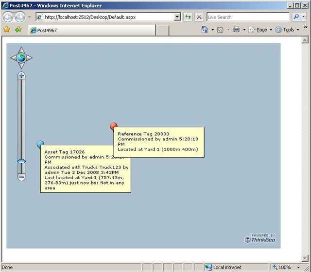

Tony,
After having looked at your ScreenShots Goal, I think the attached demo is ideal for you, which uses popup for marker labels and here is the screenshots.
Here are the answers of your questions.
1, now we don’t support specifying a string containing 1 or more custom data fields directly, but you can write your own TextStyle and implement it.
2, about label cutting, please have a look the post here, which has a detailed explanation why we have labels cut and how to solve it.
Any more queries please let us know.
