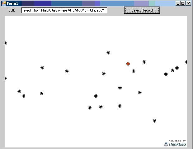

I have another problem with the new version.
In the last version i can "select" a feature with this code:
Dim Pinteres As New Layer(Module1.getRuta & "\Mapas\espes2________pi.shp")
Dim color As GeoColor = GeoColor.FromArgb(200, 255, 69, 0)
Dim brush As New GeoSolidBrush(color)
Dim symbol As New PointSymbol(PointStyleEnum.Circle, brush, 8)
Pinteres.SelectSymbols.Clear()
Pinteres.SelectSymbols.Add(symbol)
Sql = "select * from espes2________pi where ID = 3"
Dim selects As Integer() = map1.Layers("espes2________pi").SQLQuery(Sql, "RecID")
map1.Layers("espes2________pi").Selects(selects)
But now I can't do it with the class ShapeFileFeatureLayer. Any ideas?
