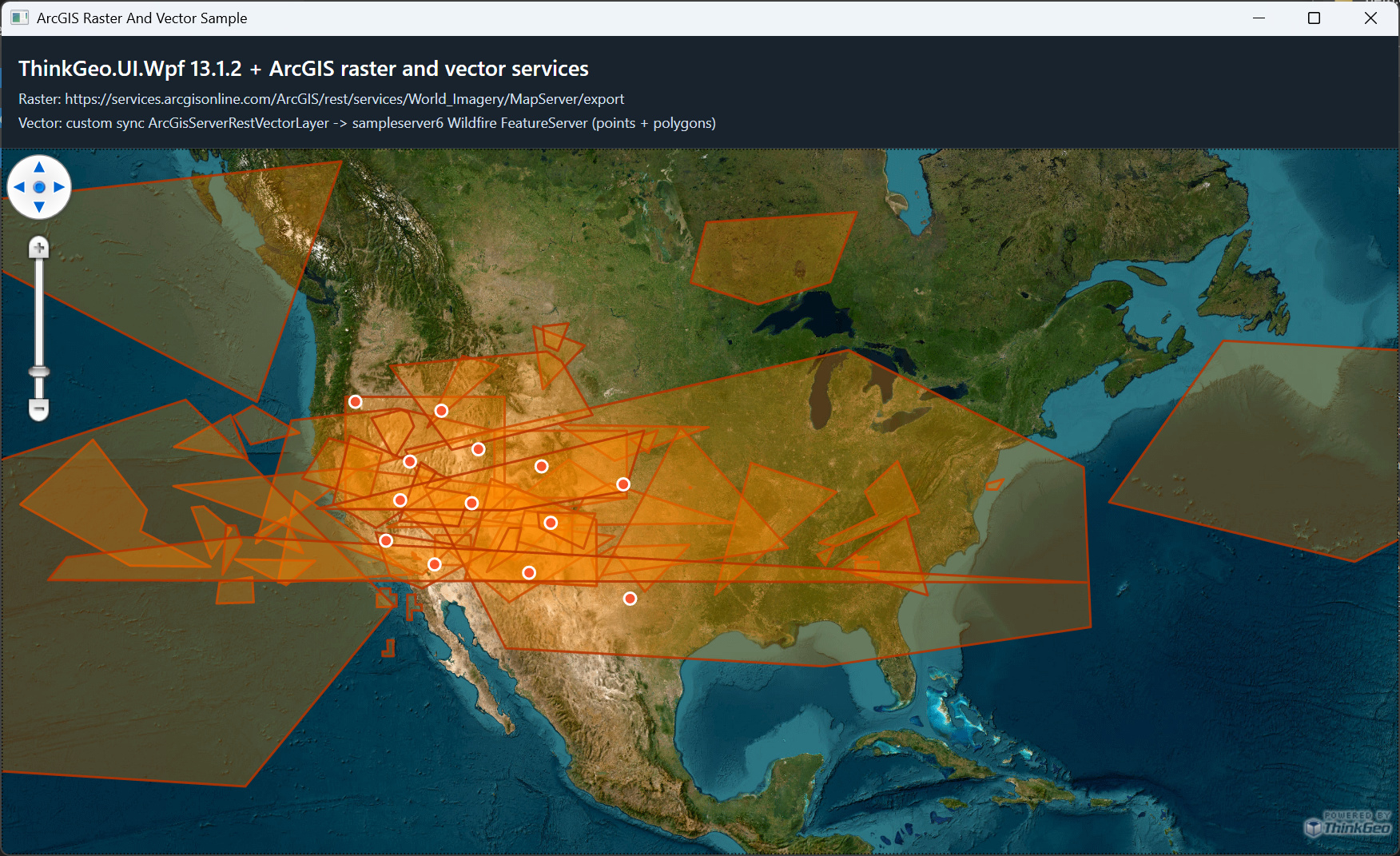

Hi Dan,
We created a Non-Async ArcGis vector layer for you based on v13.1.2. Here the demo below shows ArcGis Raster and Vector on the same map, please take a look.
ArcGisRasterServiceSample.zip (10.0 KB)
Thanks Ben! That’s some nice work, I can definitely use this.
