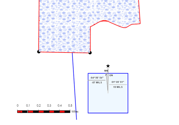

I am having trouble when I add a MagneticDeclinationPrinterLayer to the MapPrinterLayer. It will not draw the North arrow, just draws the background mask. I have included a sample project.

It’s because the MagneticDeclinationPrinterLayer only supported Decimal Degrees. We’ve made some changes, can you:
  1. Upgrade to the latest beta 14.4.0-beta024
  2. After setting the MapExtent, also set the Projection for the PrinterLayer.
    PageLayout.PageLayoutMap.MapExtent = MapUtil.GetDrawingExtent(moLineShapefile.GetBoundingBox, CSng(PageLayout.PageLayoutMap.GetBoundingBox().Width), CSng(PageLayout.PageLayoutMap.GetBoundingBox().Height))
    PageLayout.PageLayoutMap.Projection = New Projection(EnumCoordSys.NAD83_UTM_zone_16N)
It should be working fine
