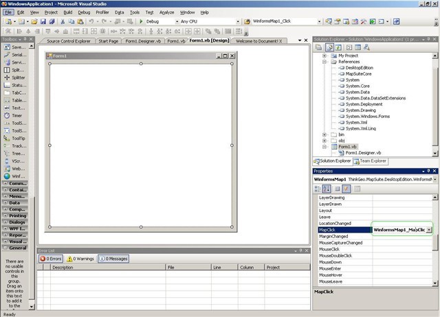

You can easily add an event handler in the VS designer. As the picture below, you can click the map control, click Events Button in the property window, and then choose the event you want to add.
Or you can directly add the following codes to hook up the event.
Private Sub WinformsMap1_MapClick(ByVal sender As System.Object, ByVal e As ThinkGeo.MapSuite.DesktopEdition.WinformsMapClickEventArgs) Handles WinformsMap1.MapClick
End Sub
Any queries please let us know.
