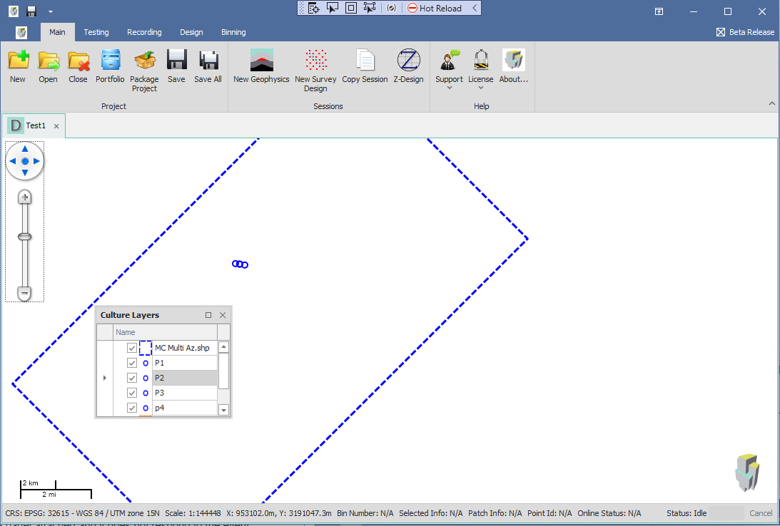

An update for you. If I tear off the docked panels, the map again receives focus and it starts responding to the MapKeyDown event. These same panels are in my v10 project and there is no issue. The only difference there is that the map control is embedded on the form in my v10 project and here I programmatically add the map to the control at runtime (being sure to Bring To Front the map control).
Here’s some images. This first one has the panel attached and it does not respond to the event.
This one with the panel detached does respond even though the panel is floating over the map. Notice how the navigation control appears to be focused in this image…

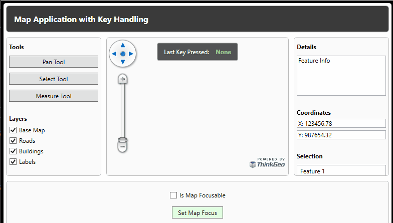

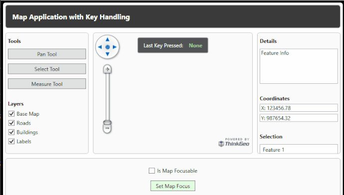

I created a sample to demonstrate this issue. The left and right panels were designed to match your scenario, so the buttons, checkboxes, and textboxes were not working.
As you can see from the gif, if the Map’s Focusable is false, MapKeyDown event doesn’t fire even I click the map or click the button “Set Map Focus”. If the Map’s Focusable is true, MapKeyDown enent can fire properly.
MapKeyFocusExample.zip (12.0 KB)

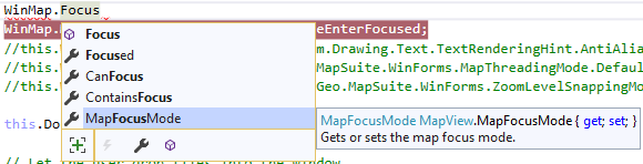

Hi Leo,
In WinForms, there is no such property. Here’s the options. I have tried setting MapFocusMode to MouseEnterFocus, but that appears to be the default in the first place. Note that the CanFocus value does show False…

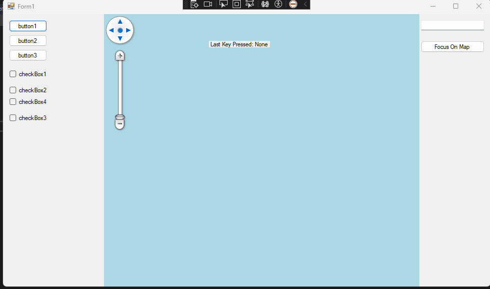

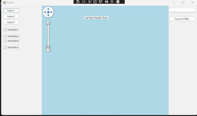

Just realized that you’re using WinForms. You could use the code blow in mapView1_MapMouseDown event to focus on the map. You need to add PresentationCore and WindowsBase to your project refrences.
mapView1.MapTools.PanZoomBar.CurrentMap.Focusable = true;
mapView1.MapTools.PanZoomBar.CurrentMap.Focus();
In the sample below, I clicked the map or clicked the button “Focus On Map”, the MapKeyDown event can fire properly.
WinFormsMapKeyDownIssue.zip (14.3 KB)
Leo
It works! Thanks Leo.
