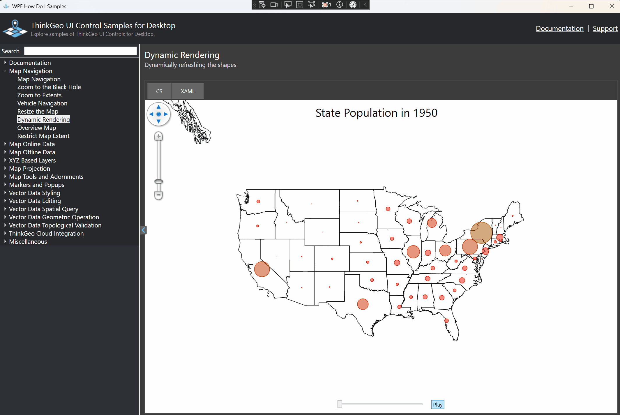

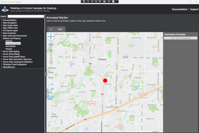

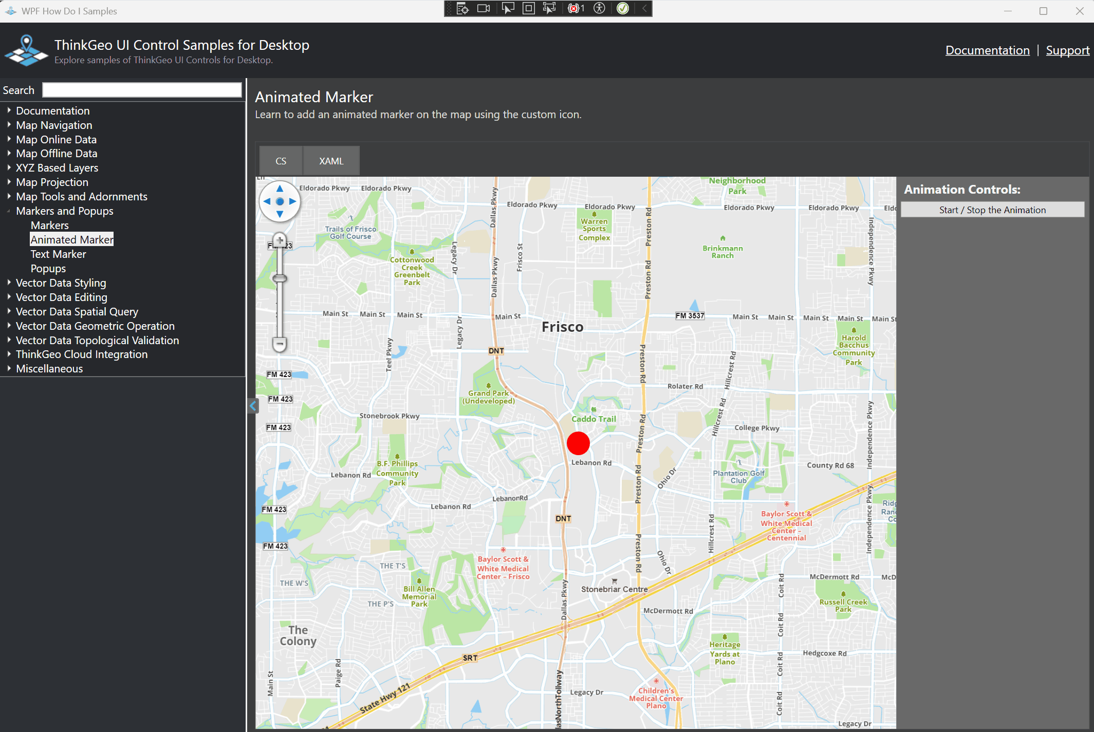

Hi Dennis,
The easiest way is to create a dynamic marker, we don’t have a GPS point sample, but this one should be a good place to start with:
If marker doesn’t work for you, you can also use FeatureLayerWpfDrawingOverlay to display dynamic shapes, here is an example how to use it.
Both of them uses hardware acceleration. This is the HowDoI repo: samples/wpf/HowDoISample
