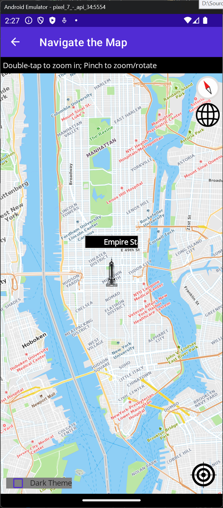

We do show this feature in the Maui HowDoI, you can see it right after launch it
Just click the button on the bottom right:

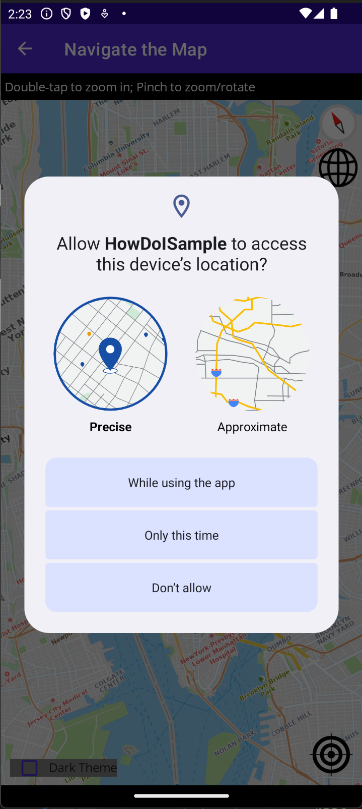

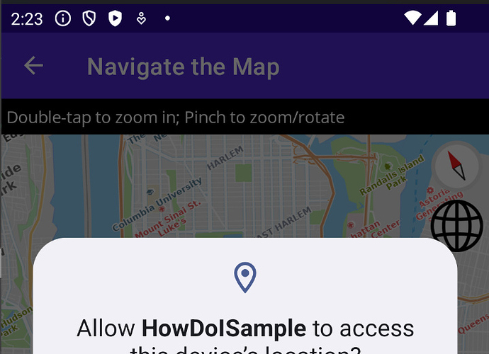

and you can see the following message popping up if it’s running the first time

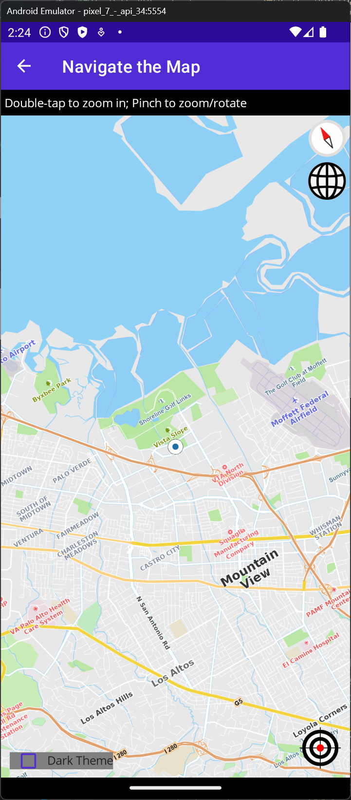

Give it the right permission and it brings you to the current spot with a breathing GPS point in the center.
And just FYI, we do show this feature in our Desktop HowDoI as well :).
