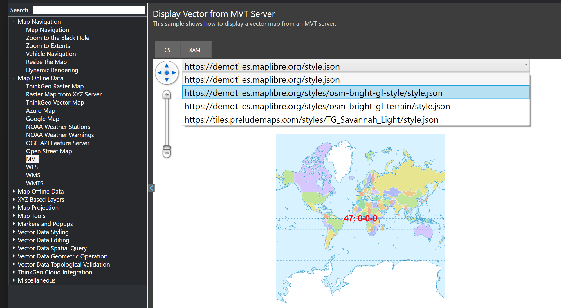

Hi Jimmy,
Yes – ThinkGeo supports PBF‑encoded vector tiles via our MvtTilesAsyncLayer , which is available in the latest beta and will ship in v14.3.2 (be releasing by early next week). Here’s how it works:
  1. StyleJson‑driven
    You point MvtTilesAsyncLayer at a StyleJson file that defines both your styling rules and the PBF tile endpoint. The layer will fetch and render standard Mapbox Vector Tiles without any extra conversion.
  2. Sample code & demo
    We’ve included a working example in the WPF “HowDoI”, using JSON from the MapLibre demotiles repo. (Screenshot below for reference.) We’re planning to add the same demo to .NET MAUI samples after v14.3.2 release.
  1. Ongoing improvements
    We’re rolling out richer MVT support (performance tweaks, feature filtering, improved styling) in v14.4. It’s a great time to switch over—just let us know if you hit any snags. We are trying to enrich the pbf/mvt support and polish any rough edges.
Hope that helps!
