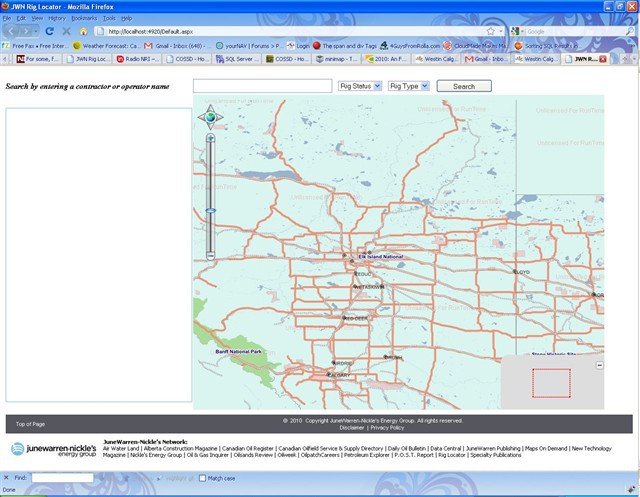

I am working on creating a web-mapping application using ThinkGeo MapSuite. I want to use minimap for my applicaiton, but the box for the minimap remains empty. Please see the attached screenshot of my web-mapping application. I have tried using server side as well as client side code to enable minimap but it is blank in any case. I would appreciate your help in resolving this issue.

 From the screenshot, I’m not sure if you are using WMSOlveray or LayerOverlay. If it is, I’m sure there is no problem. Could you give us a small demo about the issue?
 There are some issues if the minimap uses Google or Virtual Earth as baseOverlay. If it is, could you give us details about your application to make sure I can give you a workaround?

Thanks for your reply. I am using LayerOverlay only and map is created using our own data. I am not using Google or Vitual earth, but still minimap is not working for my application. Please find a poriton of the code below:
LayerOverlay shapeOverlay = new LayerOverlay("Shape Overlay", false,  TileType.MultipleTile);
shapeOverlay.Layers.Add(neatLineLayer);
Map1.CustomOverlays.Add(shapeOverlay);

 The MiniMap doesn’t support overlays which are non-baseOverlay, so you need to set the second prameter “IsBaseOverlay” to true like below:
 LayerOverlay shapeOverlay = new LayerOverlay(“Shape Overlay”, true,  TileType.MultipleTile);

Hi Johnny,
Minimap works now.
Thank you so much!
