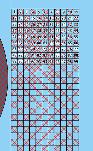

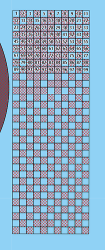

I’m trying to figure out why the labels are not showing at all zoom levels, and how to get them to do so regardless of overlap.
As you can see, the boxes get labeled up until, I’m assuming, the text would be bigger than the polygon.
How can I override this so the labels are always shown?

Hi Aaron,
Just comment out the following line.
FittingPolygon = true,
That did it. Thanks.
